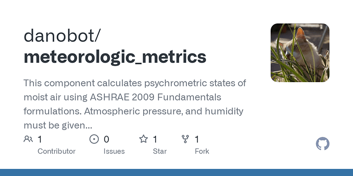

To my future self, I tried adding the following via HACS, using my local Temp, Humidity and pressure sensor values, but the wet bulb came across as an attribute and was not reliable.
