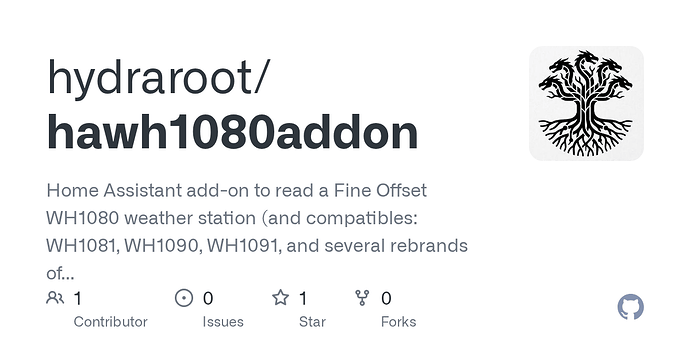

GitHub
The project is available here:
The repository can be added as a custom add-on repository in Home Assistant.

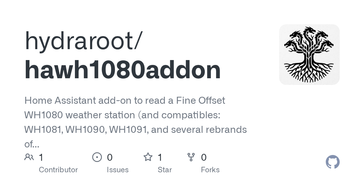

GitHub:
