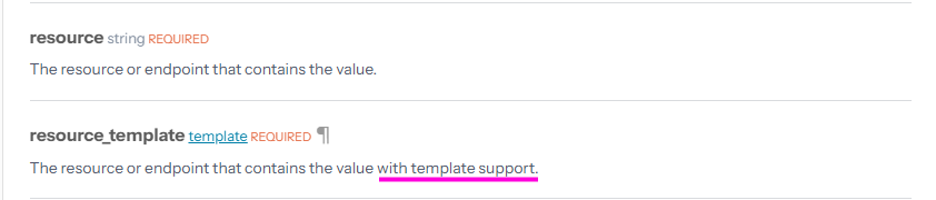

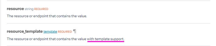

Always check the integration documentation.
To use templates in your resource you need to use the second option:
https://www.home-assistant.io/integrations/sensor.rest#sensor-rest-configuration-variables
Replace
resource: https://api.open-etc...
with
resource_template: https://api.open-etc...
OMG, that fixed it so fast! Thank you very much!
That resource_template is the magic word!
