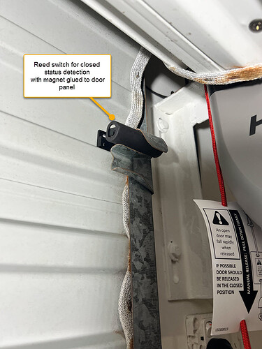

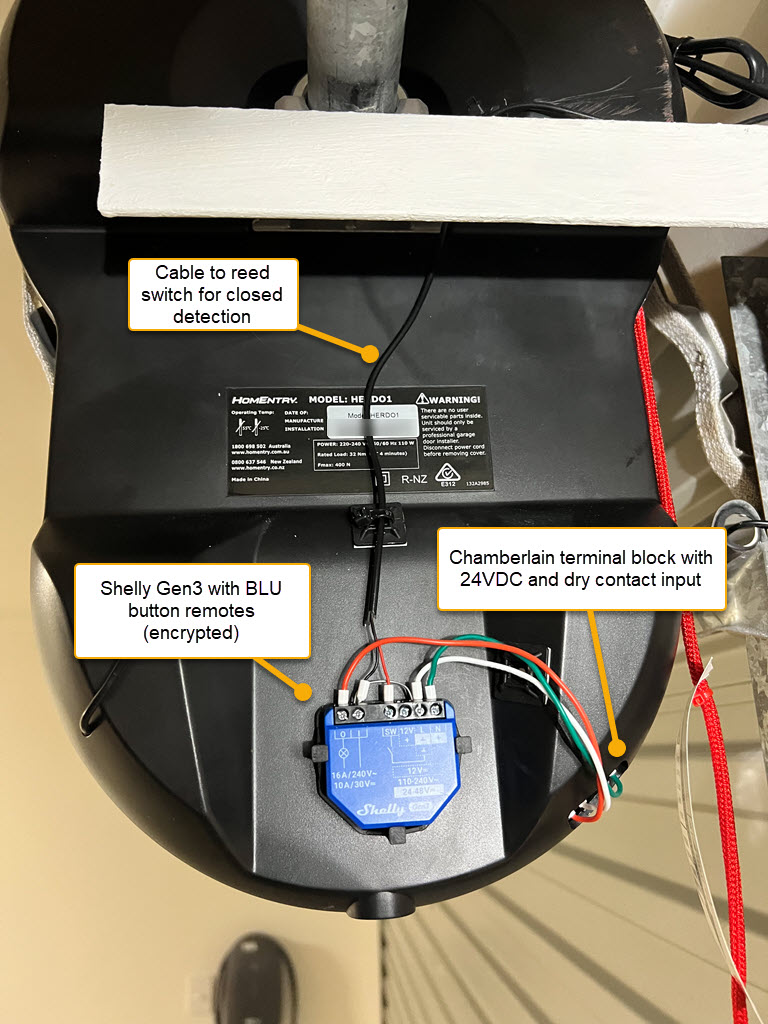

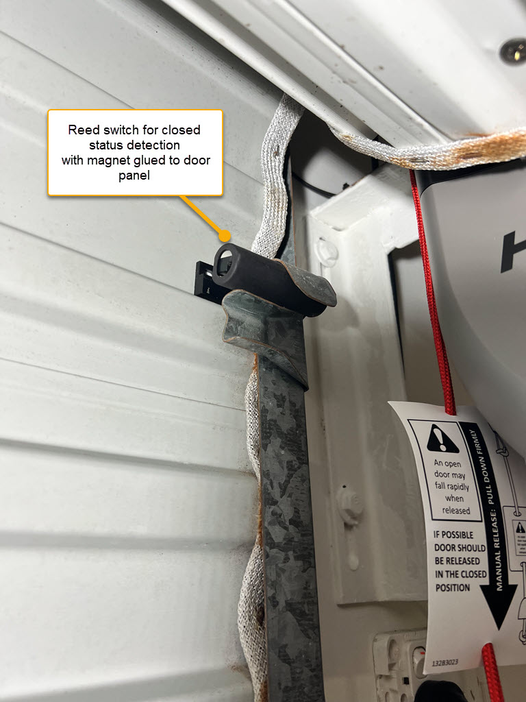

Market is so limited here in Australia with the Chamberlains dominating. And I have a roller door which means all the Chamberlain brands incl. Merlin and HomeEntry won’t work with ratgdo due to the missing serial interface in the roller lifts. I ended up using the cheap HomeEntry HERD01 from Bunnings with a Shelly 1 Gen3 and encrypted Shelly BLU bluetooth buttons as remotes. Added a reed switch for close status. Works well with HA. I would have loved to get the intermediate states like opening/closing and open into HA like you can with the serial Security2.0+ protocol. It turned out to be a neat solution as the roller lifts offer a 24V supply:
