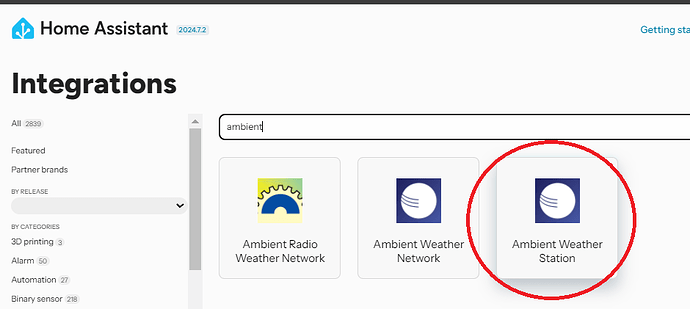

There is a diffewrent way to get the raw data from your weather station as I explain later in this thread, but how come you aren’t using the ambientweather weather station integration?
Note the circled one only:
I have a Raspberry PI 4 (hostname “kruse-pi”) running Home Assistant Supervised on Debian. It is also using the ambientweather integration (not sure if that also uses the cloud but I did not think so). I thought that integration connects directly to the console (note the “aioambient” process shown below), because here is an example of the data it is getting every 16 seconds to feed into Home Assistant (the below snippet is from the syslog on the RPI host):
Jul 18 21:46:52 kruse-pi homeassistant[1494]: #033[32m2024-07-18 21:46:52.912 INFO (MainThread) [aioambient] Received packet MESSAGE data 2["data",{"dateutc":1721353560000,"tempinf":77.9,"humidityin":40,"baromrelin":30.003,"baromabsin":29.944,"tempf":75.4,"battout":1,"humidity":60,"winddir":259,"windspeedmph":0.7,"windgustmph":1.1,"maxdailygust":11.4,"hourlyrainin":0,"eventrainin":1.138,"dailyrainin":0.008,"weeklyrainin":1.138,"monthlyrainin":2.539,"totalrainin":30.378,"solarradiation":0,"uv":0,"temp1f":78.1,"humidity1":44,"batt1":1,"batt_co2":1,"feelsLike":75.46,"dewPoint":60.53,"feelsLike1":77.7,"dewPoint1":54.4,"feelsLikein":77.3,"dewPointin":51.6,"lastRain":"2024-07-18T07:46:00.000Z","tz":"America/New_York","date":"2024-07-19T01:46:00.000Z","macAddress":"##:##:##:##:##:##"}]#033[0m
