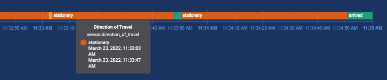

I made a trip this morning and the garage door was open when I pulled up to it. I had added an additional or condition=stationary and the automation triggered at 11:33:24 when close_to_home became < 500. At that moment, direction_of_travel was stationary and had been for 44 seconds.

It would be nice to figure out why my trips keep triggering stationary especially when close to home.
This trip there were 2 or 3 short stationary periods near the beginning but the last half or more there were zero stops…

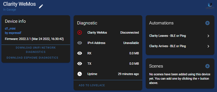

its only going to work when the D1 mini joins the networks
when the car is switch off or leave the network ← this we DONT know which but I DONT want to know that I just want to know when the car join the network and it open the garge that all i use it for
I use differance logic for tracking person
this was my mark 1
until I updated my MQTT could not get it to work so that when I did the esphome one
for faster join to the net work give a static IP
unreliable for me = proximity sensor!
The D1 mini is working as well as my Clarity’s Wi-Fi ping sensor does but both make me sit and wait a bit for the door to open and so far the ping sensor has beaten it. Today I added back the proximity sensor and it was first to trigger such that I only had to slow down a little as the door was opening.
I now have 6 entities triggering the automation and keep track of the trigger id with an input_text helper: WeMos D1 mini=on, BLE dongle=home, Clarity Wi-Fi ping=on, direction of travel=arrived, close to home=on if < 500.
Good suggestion about using static IP! I am setting that now…
