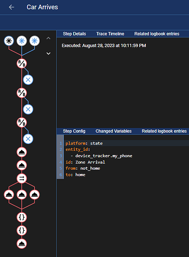

@dbrunt mind sharing your automation YAML/steps for this? Curious if you set it up using zone triggers or something else. Thanks for sharing your method and updates in a clear and easy to understand post!
Edit
Ah… Figured out that the device_tracker entity actually reports the zone as it’s state! Docs FTW :slight_smile:
“If you’re using a presence detection method that includes coordinates then when it’s in a zone the state will be the name of the zone (case sensitive). When a device isn’t at home and isn’t in any zone, the state will be 'not_home' .”
Device tracker - Home Assistant
You can also add a condition in the automation’s that checks if a tracked device is still in the zone after it enters it as well before an automation is scheduled to run.
i.e Trigger is Phone being home or away via choose and in choose options the condition it will validate that its inside the zone since it last entered it and say Android Auto sensor is set to on in the companion app so it knows you are in the car.
