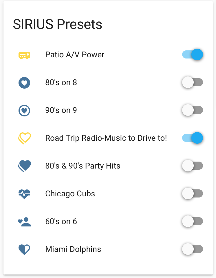

I am about to show you my Sirius Presets card I use. The first photo I will show is completely with everything showing off. Instead of using the on off for two separate lightning bolts (one for off and one for on) I am using a toggle on/off by using assumed_state: false within the switch in the customization file. I will follow the photo with a detailed explanation of its use:
Sirius All Off:
Here is an example of the power command line switch and the 1st preset:

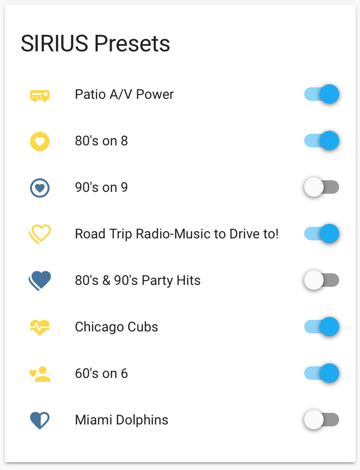

It is with the Presets which I seek ideas or suggestions from the community. When I toggle a preset whether from on or off for the same Preset it will toggle the icon to either on or off based on how many times it is pressed. What I am wanting to do is find a method to remember what preset was last selected. The issue is let’s say I start by selecting a single channel such as 80’s on 8. The toggle will reflect on and turn blue and the other MDI icon is yellow. I want this to be the case for just 1 channel at a time. However when I change to an alternate channel such as Road Trip Radio, now I have multiple channels showing as on. Below is a photo showing multiple channels being on; it reflects the power of A/V being on with several Presets showing on (or active in my case):
Sirius Unfortunate Reality:
This is what I would prefer to be shown at any given time:
Sirius Ideal:
The above shows the power state of the Patio A/V equipment. It also shows one active Preset.
The assistance I am seeking is the best method to this. Ideally I am always starting from blank showing all presets off and the A/V system as off. I turn on the A/V and its state shows as expected. I will then tune a Preset such as 1 and that shows as on. Once pressed I want it to stay on until I select a different preset. Let’s say I then press Preset 3. I want some type of method to know to now turn Preset to an Off State and turn Preset 3 to an On State. Then when pressing each subsequent Preset it turns the newly selected one to On State and also turns the previous one to an Off State.
