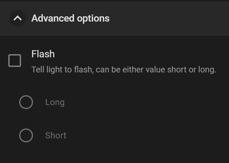

What is new Light Flashing feature?
Looking at the latest Home Assistant 2026.2.3, there’s this funky light flashing section to the light.turn_off action:
What does this do exactly? I tried it out, and the light just slowly turned off like normal. No flashing.

Can’t speak to the turn_off action, but it’s definitely been a thing with the light.turn_on action for some time (like years?).
Light integration docs - turn_on, that’s pre-2026.3.0… I think your light might need to support it natively Edit (mine don’t) much like the effect: (and others) data key.
Which lights would support it? I have IKEA and Philips Hue Zigbee as well as LIFX.
No idea, none of mine react to it.
I just tried flash with a Philips Hue bulb (model: “White and Color Ambience”). It flashed on/off 15 times for long and once for short.
The flash option has always been a bit weird. Different devices respond to it in so many different ways that it can be really frustrating to use if you’re looking for a uniform experience.

After more testing only with light.turn_on, I was able to get my Philips Hue lights (white ambience) flashing with Home Assistant using the ZHA integration. 1 flash for short and 15 for long.
It doesn’t matter if the lights are already on when you call the action, and you don’t need to configure any other settings.
