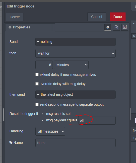

I do not know it is the best way. But this is how I do it:
I the door is closed within 5 minutes the timer will stop
If you want to check the door again after 5 minutes place a current state to check and go back to the timer again for another 5 minutes (or earlier if the door closes_)
Thank you this is also an interesting way to interrupt the cycle. This shows that there is no single ideal best ways, all of us have a best way, I like creativity …
