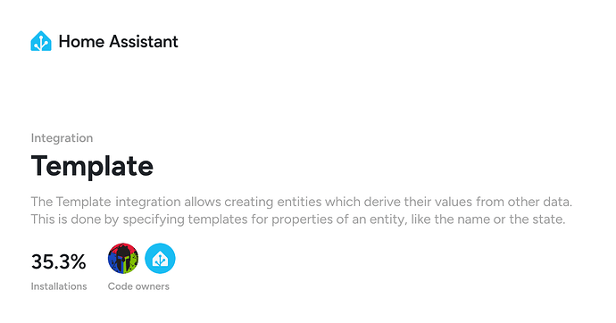

As Edwin said, there's no availability template in UI-created template sensor helpers (2026 update: there is now). If you need to set availability, you'll have to use YAML: here's the documenation.
You should quote the string against which you are comparing the state of your (non-binary) sensor, otherwise it'll be interpreted as a variable called consuming which doesn't exist.
Also, if you're setting a unit of measurement, the state must represent a numeric value unless the availability template returns false.
A full template sensor in YAML might look like this:

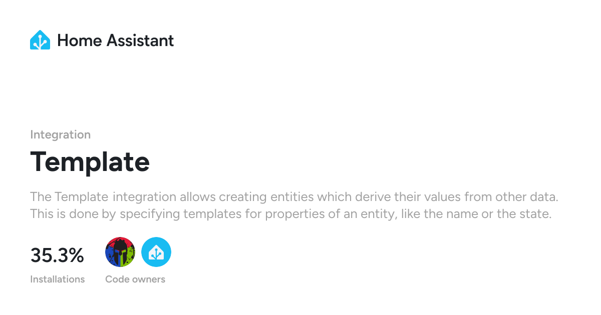

there’s no availability template in UI-created template sensor helpers
It's 2026 now and UI-created template helpers do have an availability template field.
Just in case somebody comes here via search.
