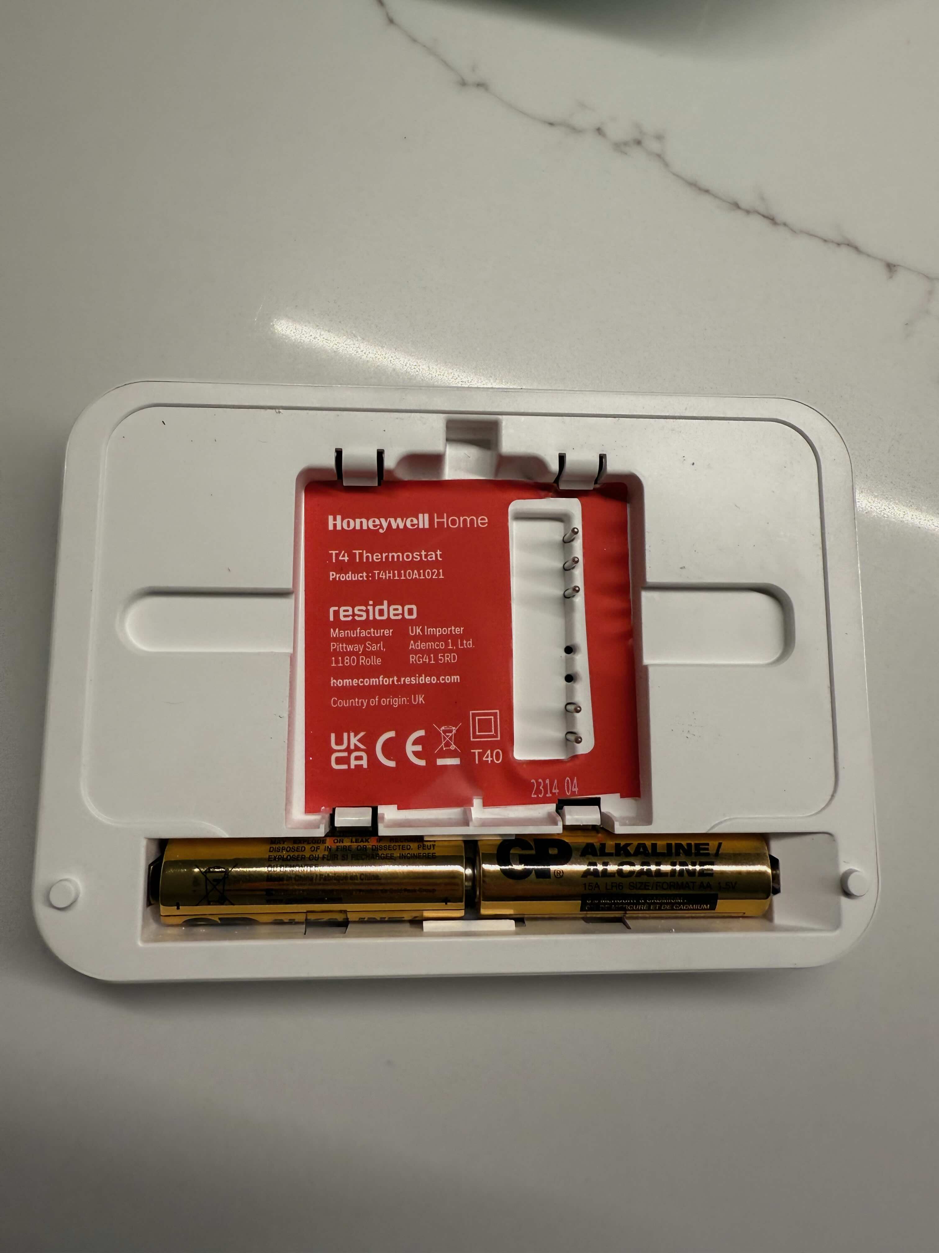

I have a Honeywell Home thermostat running a heat pump style boiler for our hydronic in slab heating.
I would like to replace it with a ‘smart’ HA friendly thermostat.

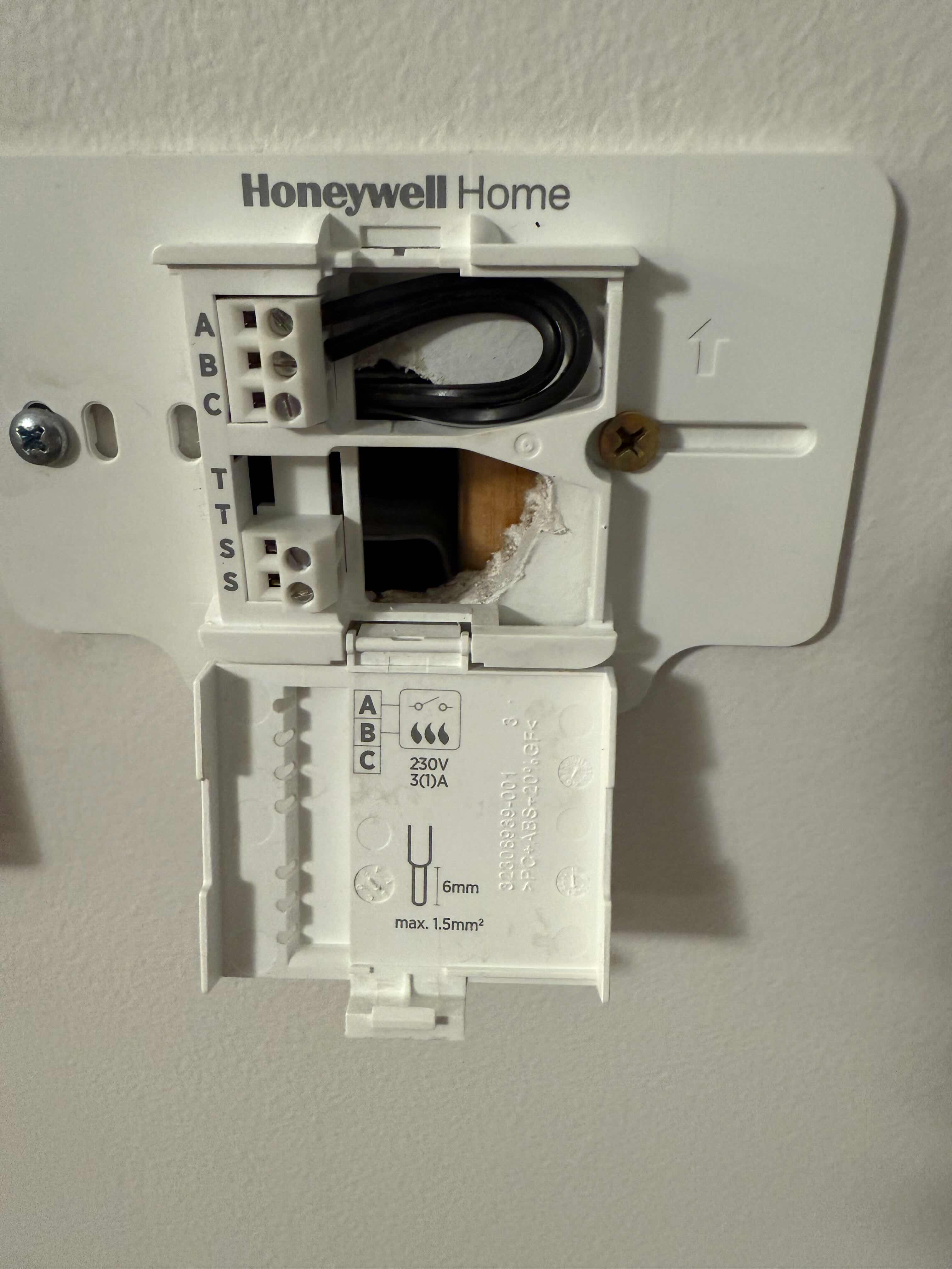

It is battery powered but I have power close by I could run. The wires back to the outdoor unit are the classic 2 wire in black and black/white. See photos.

Photos show how it is wired.

It seems a normal dry contact/voltage free thermostat.
You can replace it with any thermostat that has a built in relay.
If you want a WiFi one you’ll need to take mains power to that socket .
If you feel lucky (and don’t need an interface) you can use any smart relay coupled with an external temp sensor.
