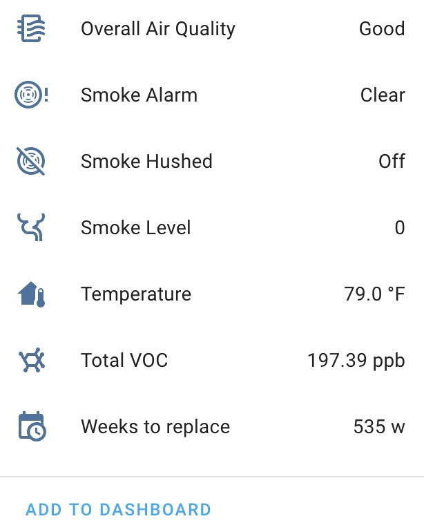

I just replaced 3 expiring Nest Protects with these: https://www.amazon.com/dp/B0CP9YPWL7

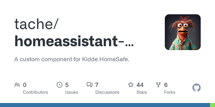

I connected them to my 2.4 IoT network and then got them into home assistant using the integration from tache (thank you!). So far so good, tons of sensors exposed.
Lots of reports of false alarms in reviews of those Kidde smart detectors - how’s the first 30 days been?
