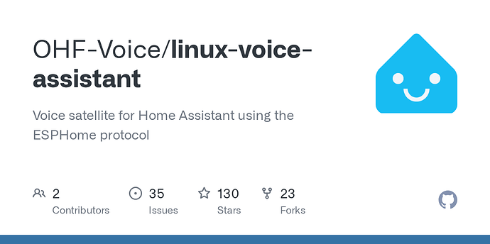

Linux based Voice Assistant
successor to wyoming satellite
