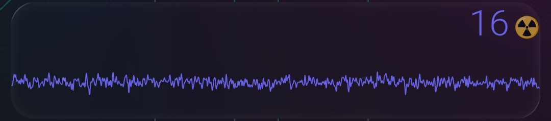

I recently programmed a C6 to interface my Geiger counter to HA via Zigbee. Quite a bit of stuffing around but I got it going in the end. Had to pass the counts per minute as a temperature since the ESP32 functions in HA are a bit fresh still. Eventually HA will add the appropriate endpoint types and I'll update the device.
For now it is working well and I will put it in an enclosure in the next week or so. Has been running for over a month without fault so far.
This is a plot of the 5-minute running average.
Did not realize I needed a Zigbee Geiger counter until now, so thanks for that ;D. Great build.
The "CPM as a temperature" trick is the right call: on ESP32 the component only maps binary_sensor to binary_input and numeric sensor to analog_input, and the analog one doesn't always surface cleanly in ZHA/Z2M, so borrowing a recognized cluster like temperature reliably gets you a proper sensor entity with a unit. Smart workaround, not a kludge.
If the degrees label bugs you, override the entity's unit_of_measurement and name to CPM on the HA side (or with a small Z2M converter), the temperature cluster just stays the pipe. Drop-in swap once ESPHome adds the proper endpoint types.
