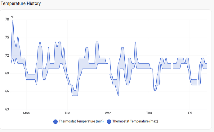

The gaps in this chart show where the thermostat was off-line.
