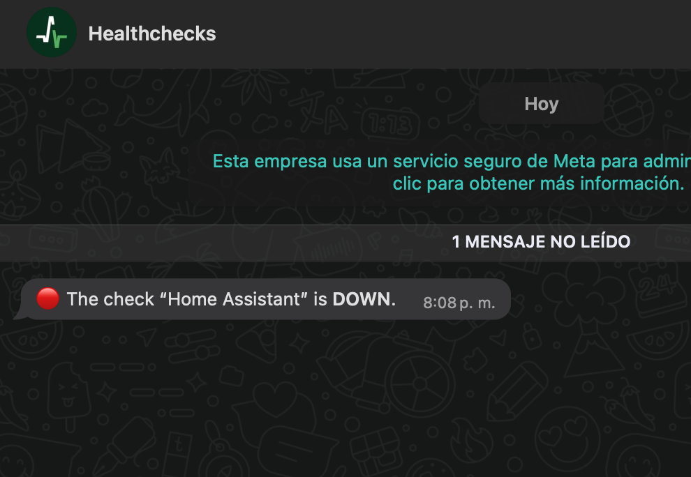

I use healthchecks.io
It’s free and I just set up an automation to ping the URL they gave me every 5 minutes. If it doesn’t get a ping in 15 minutes it sends me an email.

Healthchecks.io mentioned above does something similar, but it would require another cloud service, and a webhook is likely a bit stricter test to see if HA is actually working. Upside of that is that it does not require your phone to be working (provided the notifications go to multiple devices).

I’ll give it a try, thank you very much.
Thank you for the suggestion. I’ll give it a try. Other than that, it’s exactly as you said: it’s not that I’ve set up an ad-hoc installation for security reasons. It’s just that, like many of us, I want to get a little more out of this setup and use those sensors while I’m away from home. Enough so that if they detect movement or presence, I can call my neighbor and ask them to check what’s going on.
