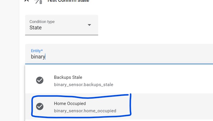

When I add this to an Automation, why is it that binary_sensor.home_occupied is not listed as a State to select in a Condition? Do I need to separately create the actual sensor?
It is not an automation… why are you adding it to an automation?
Seems I’m confused then. I guess the template is it’s own thing. I just add it to my config?
Got it sorted out. Again, thanks for all the input!
