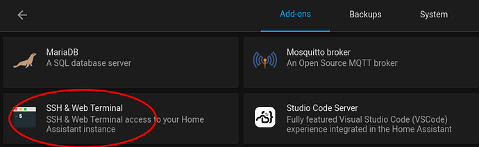

How did you setup SSH access?
The command is:
docker exec -it homeassistant bash
without ha

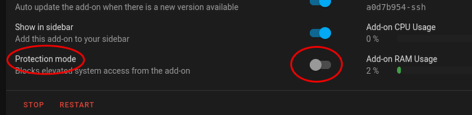

The guide is about the addon-ssh
and the protection mode has to be disabled for the docker command to work.
This worked - thanks a lot. I overlooked that this is the other SSH add-on…
