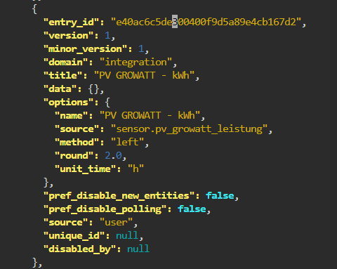

What is the current file where I can find more about the helper or at least the riemann sum integral needed for all the energy calculations ?
I have looked into a few of these files and I could identify what they were for but none about my helpers so far.
thanks
Yes, it’s not a helper, it’s in config_entries.
Sorry, it was my fault.
I had opened the file and tried to scroll down with the touchpad but it did not move. Therefore I had assumed to be at the end of the file and nothing more to be find.
but here scrolling down with the cursor or rather searching backwards with ctrl + q I found my helper integral
and was able to edit it (carefully).
thanks, that had solved my problems and will maybe solve those of others at the same topic.
It is also important to know cause the helper only asks once about left or righ edge integration while in this file editor you can change easily afterwards. For a Riemann sum integral a lot of parameters have to be adjusted and I hated it in the past cause I had to delete the helper first and better relaunch ha after that to rebuild a new helper with all the parameters.
therefore editing here is much easier and in case something goes wrong I still have my 2 backups in the google cloud and on the NAS.
thanks a lot for your quick support !
