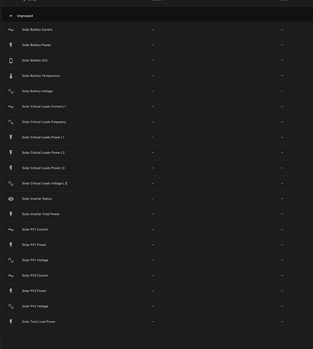

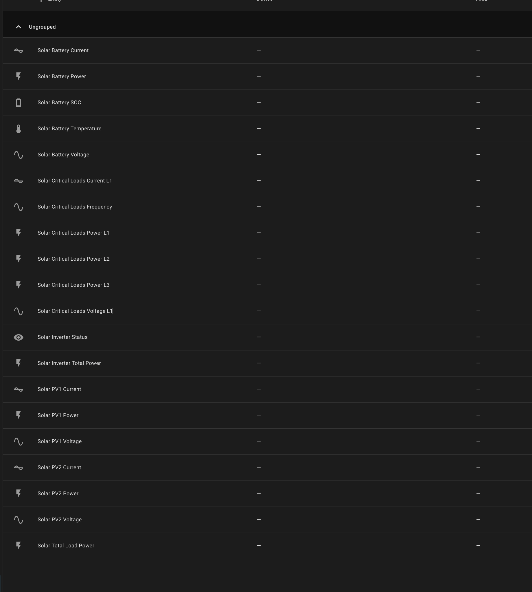

I have them already integrated and with the right device class and unit of measurement, and still they don’t appear in my energy dashboard.
Here you can see them listed:

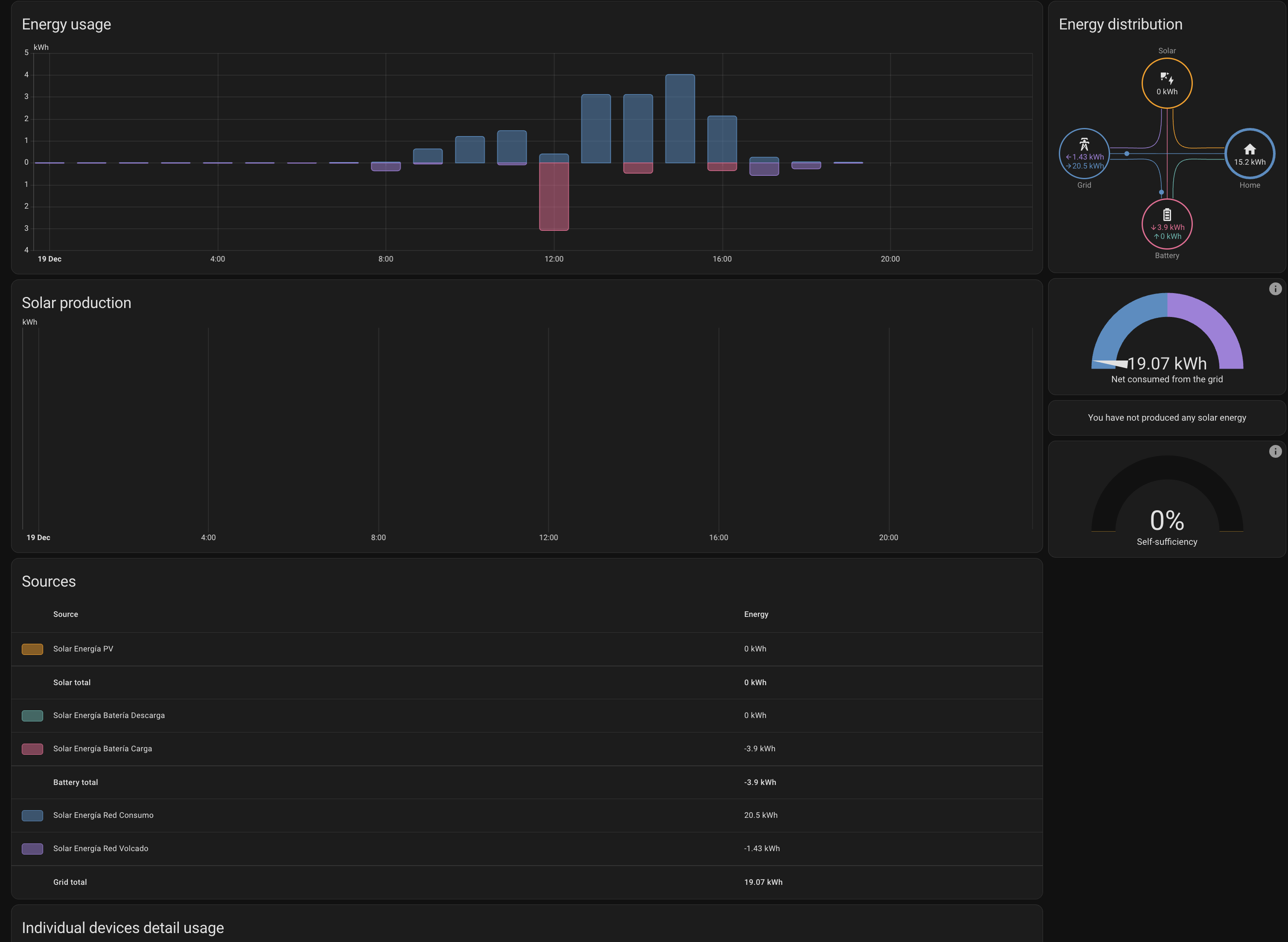

However, in my energy dashboard, I only see all the values coming from the Modbus integration that I tried earlier (didn’t removed it yet):
You are pointing out to a different problem now, how to import into energy dashboard is different then how to define them. Is the initial problem solved now?
