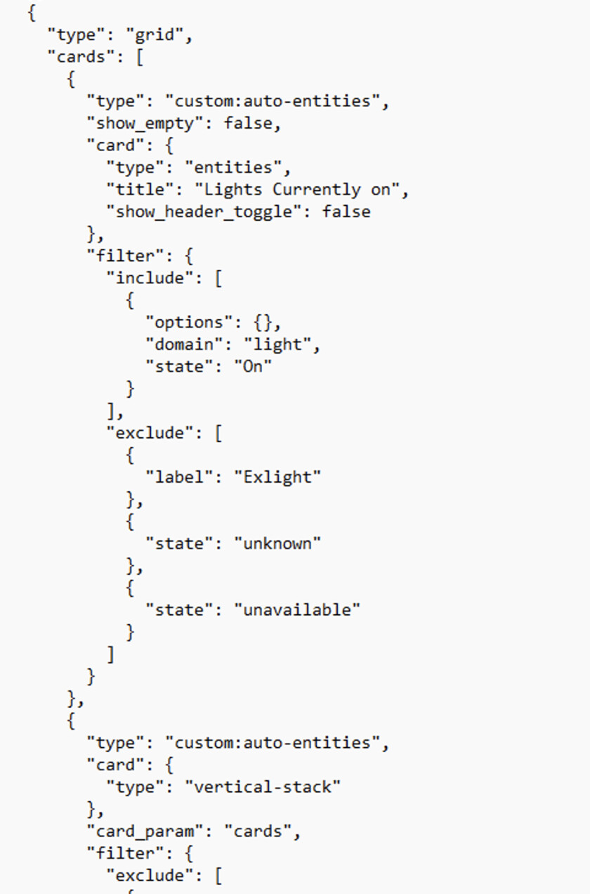

Look in /homeassistant/.storage/lovelace
This is an example of what I see in my backup, path is:
homeassistant.tar.gz/data/.storage/lovelace.test-dashboard
Same in my production env. Looks like json to me.
I could copy and paste the json to the production env, but I’d prefer to use the user interface and have that catch any mistakes before saving.
Why not just use a converter and create a copy to work with?
