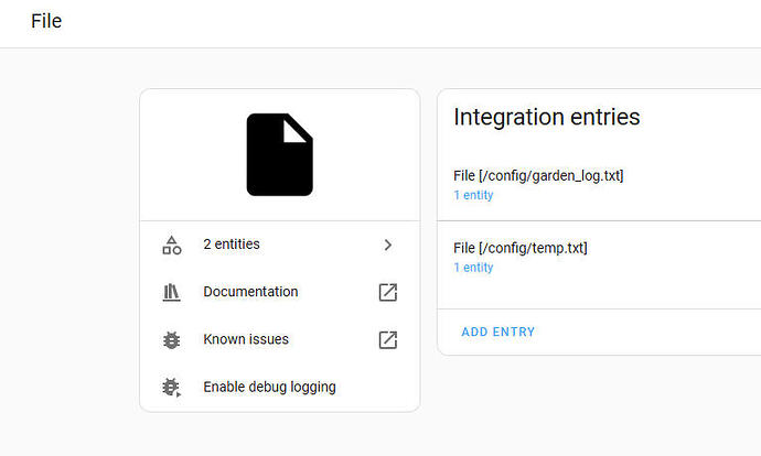

Open the file integration
Click on “Add Entry”
Click on “Set up a notification Service”
Enter the file path. It can be any file path that Home Assistant can access. (For example, /config/temp.txt will be written to the file “temp.txt” in your configuration directory)
Optionally, select the timestamp option.
This makes an entity named notify.file:
They will all be named “notify.file” in the integration. But the second one will be “notify.file_2”. The third will be “notify.file_3”.
Now, to make a meaningful name, click on the “1 entity” below the File[/config/temp.txt] to open the Entities tab.
Now click on the entity, then on the cog icon.
From here, give it a friendly name that means more than notify.file_2.
Now, when you create a script or automation, for service, select notify.send_message, and when you click on “Choose Entity”, you will see the freindly names of your file entities:

You create a file, where ever you want ( As usual “old style” ) FILE-Integration
Now in FILE-Integration UI, you can create a Sensor-File or a Notify-File
( pointing to a file of your choice ) Hint: the " File [/config/temp.txt] "
Your Dummy-file-name vs real filename And “old name”, doesn’t make alot of sense unless you show your “example”
So If you want to change the name of the file that is written to ( i.e the one by you created " temp.txt >to>dummy.txt " ) then you do it like you normally change a file name, in the filestructure, And your in UI created notify-file will not change
The Files created in the UI And the previous from config.yaml, you find in the Integration(UI), or under “Entities”
If you want a “new” notify-file or sensor-file, pointing to another temp2.txt or dummy2.txt, Yes then you have to create a “new” entry in the ( Now in the UI ) ( And ofcause new files to write to,when calling the Notify-SERVICE )
The sensor-file shows the state of the file ( Cording to the FILE-Integration, as previously “last entry” )
The Newly added feature/service Notify-File writes to the file of your choice
If you change any of these entity-names, then it’s those entity-names you have to CALL
Just like you if change a entity-name, i.e light.my_light >to> light.light_1, THEN you also have to change the name name in the i.e script/automation where you CALL this entity
So go to Devices-Services,Click i.e FILE-Integration, there you see the files belonging to this Integration
IF you by any chance i.e have Tibber-Integration, or Other Integration which Supports the Notify-Service, you will most likely also there find a i.e “notify.tibber” entity(which is cool btw)
Your Mobile-App(Integration) Support The Notify-Service
DEV-Tools: Services ,list notif
So what’s new in the UI-Version of FILE-Integration ( Beside it previous sensor-file ) Is the Notify-File
Take a look at my pics above And You’ll see where you find the file which are written to (the place you initially choosed, when you “wrote” the “PATH” in the UI (same as you had to write a PATH in Yaml)
