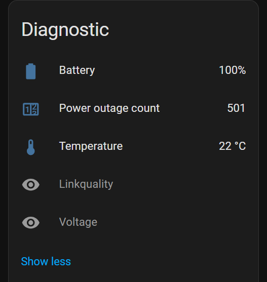

I have a button switch (Aqara WXKG12LM) which reports device_temperature.
This shows in Z2M and in MQTT debug messages in the Device Info page for the device in HA.
But the device only shows sensors for Action and Battery,
(Link Quality and Voltage are shown without values if I click ‘show more’.)

I have some WXKG11LM which look identical and they deliver temperature ok.

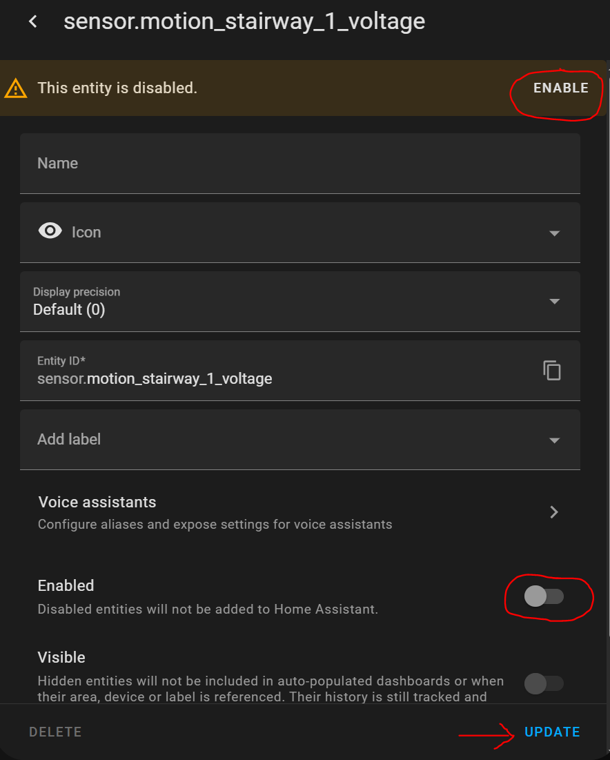

Did you enable them in the device page in HA? Those sensors are disabled by default and you have to enable them manually
Sorry, i may have unnecessarily confused. I want the temperature, which is not listed nor found in the show more section.
Are you sure the Doorbell mqtt message you’re posting belongs to the WXKG12LM? This doesn’t seem to have a device temperature according to the Z2M page.
Only the WXKG11LM lists the device temperature.
I agree that the link from Z2M to the spec sheet does not mention temperature but the the ‘state’ tab shows:
