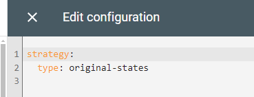

Wanted to create a duplicate of the Overview dashboard since it is well populated. AI tells me just create a new one and name it Overview 2. Nice, but it didn’t populate the dashboard with any cards. I go to the Overview dashboard hoping to copy all the yaml code and paste it in the new one, but clicking on ‘Raw Configuration Editor’ brings up a file with only:
strategy:
type: original-states

Cannot say for sure - but may be the new dashboard was wrongly added as “auto-generated”.
Dashboards created in UI (auto-generted or not) are in so called “storage-mode”, i.e. are managed in UI. There are no yaml files for them, they are stored as json. The “raw yaml editor” is in fact a “json → yaml” conversion.
Only “yaml mode” dashboards are stored in yaml files.

When I click on ‘Raw Configuration Editor’ on all of the dashboards, it still only shows: type: original-states.

i think the thing you’re hitting is that the overview dashboard by default is a special auto-generated one… at least until you customize it. so if you’re trying to create one that has the same auto-populating property by copying it’s config, i don’t believe that’s possible…
for other non-autogenerated dashboard, you can go to the raw config and copy/paste…
Yes, see same for a test auto-generated dashboard:
If you need to manage a dashboard - it should be this, not auto-generated:
