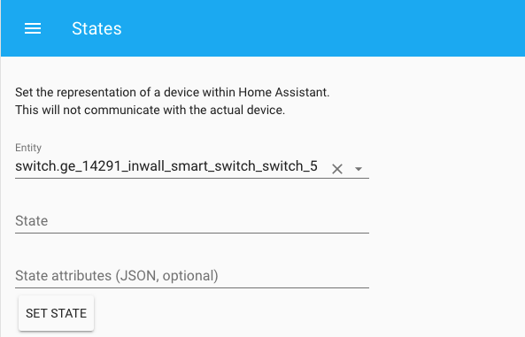

Thanks to everyone that replied! I tried your method and receive this error after clicking: “Set State”

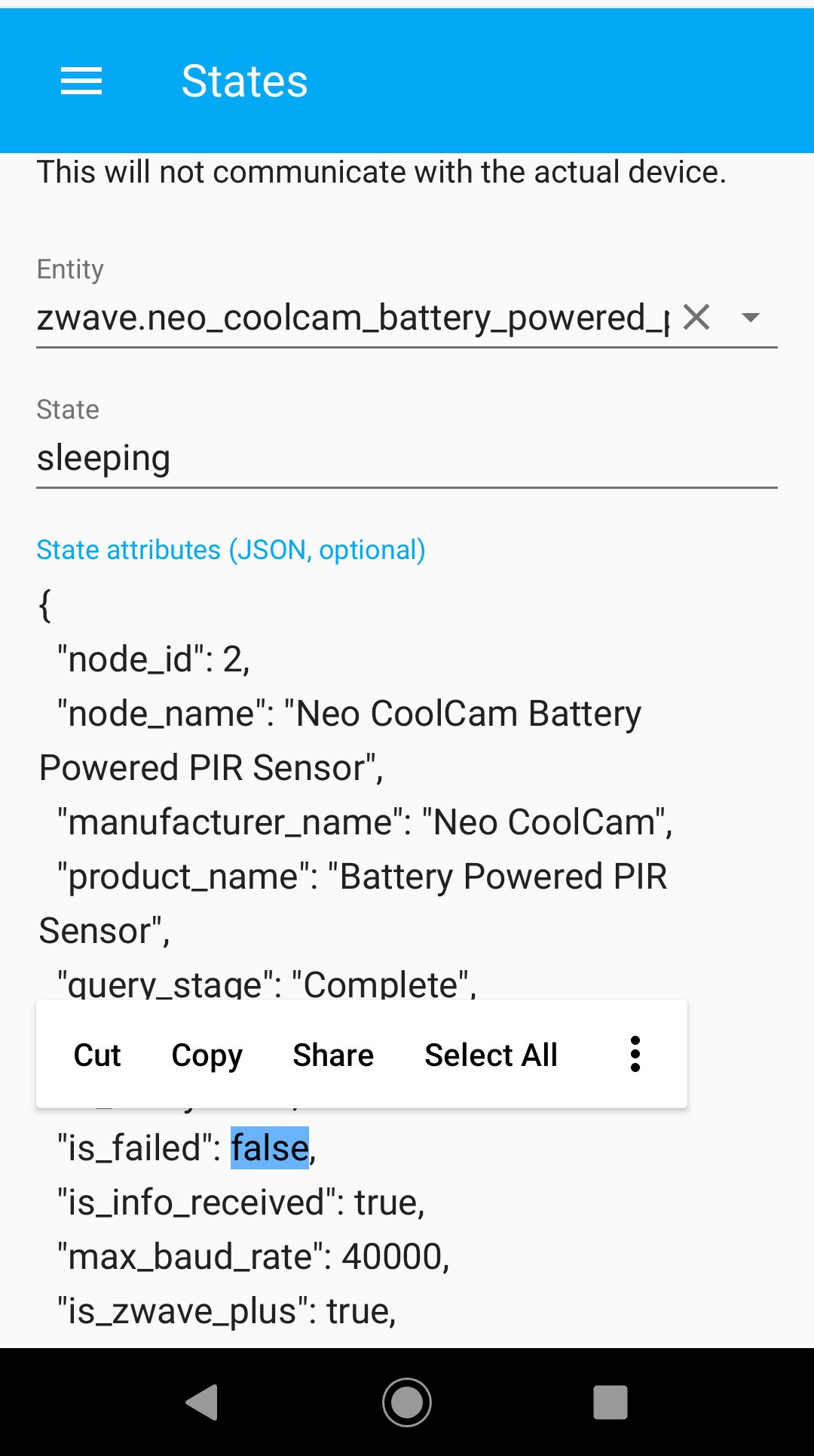

Click on the sensor in the table below, that will populate the text box with the current state in Jason format. Then find the is_failed entry and change false to true.
Looks like this:
Is there something I’m doing wrong because nothing ever populates no matter which Z-Wave device I select. I’m running Home Assistant on RPi:

For example, this is the Z-Wave switch for the kitchen lights which is paired and works just fine, I’ve waited a few minutes and nothing ever populates:
You have to select it by clicking the hyperlink in the table you see when scrolling down, not by picking in the drop down menu
Okay, now I understand what those links do. I previously clicked on them and did not realize they populated those fields because I had scrolled way down the page, clicked on a device and nothing happened so I thought it was a dead link! And what’s the point of selecting an Entity in the dropdown list if it does not populate the State Attributes? This sounds like a UI issue and really should be corrected as it was confusing to a new user like myself so I’m sure it might confuse others. Also, step 1 from the “Remove Failed Node” is mis-leading as it implies to click on the zwave device from the dropdown list. Think about it, the drop down list is at the top of the page and all the devices are there so why would one look anywhere else?
