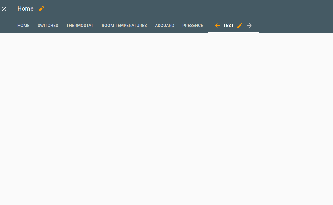

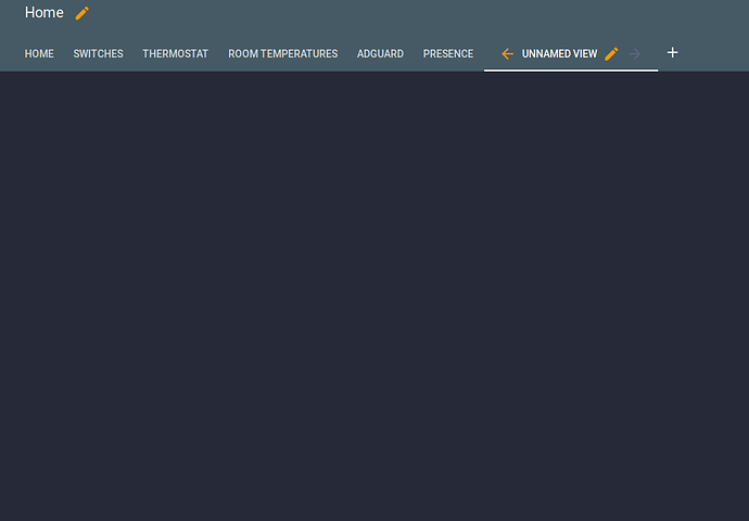

Adding this to ehe raw config editor:
  - url: /community_plugin/dual-thermostat/dual-thermostat.js
    type: js
resulted in a menu entry called ‘unnamed view’ with no contents:

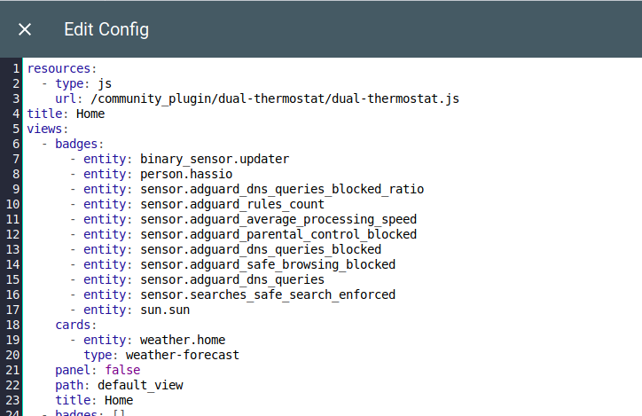

You need to add those lines under resources: in the raw config editor. Create that line if it doesn’t exist.
Have a look at this guide
I’ve added the resource to the raw config editor:

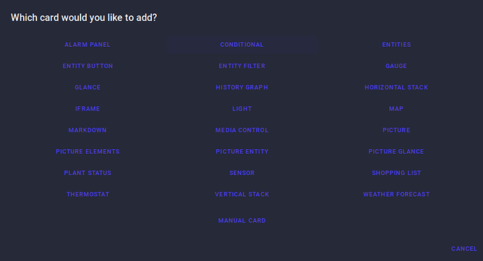

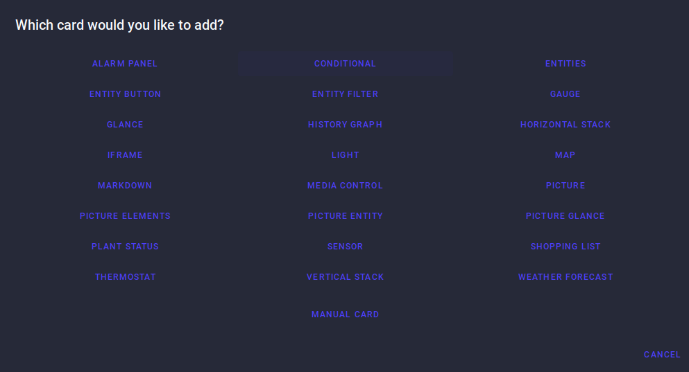

but how do I add the card, as it’s not listed:
The UI editor doesn’t support custom cards.
How would I add the custom card then?
Back to that raw editor, you’ll have to add the card manually.
Or click “manual card” and enter the card config there. The UI editor doesn’t create a new button for custom cards.

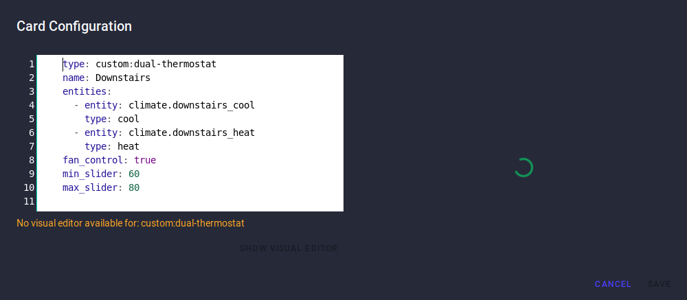

but adding this to the raw editor results in:
Screenshot%20from%202019-11-30%2014-22-05
You can paste what’s below cards: by clicking “manual card” in the UI and pasting there. Remove the first hyphen too.
But anyway, that error is saying you have more than one cards: in the YAML for that view, which isn’t valid.
It does, you just have to use the “manual card” option at the bottom.
Thanks, but entering it as a manual card results in a never ending rotating circle.

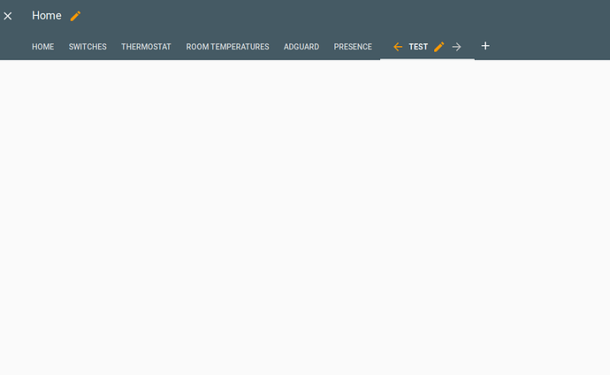

Adding it to the raw editor results in no entry in the UI:
    badges: []
    cards:
      - type: 'custom:dual-thermostat'
        entities:
          - entity: climate.downstairs_heat
            type: heat
        fan_control: false
        min_slider: 10
        max_slider: 24
