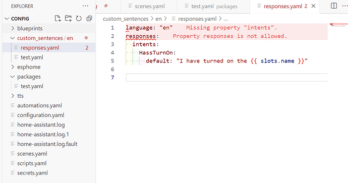

I’m following this tutorial to set custom responses for build-in intents. The following picture is the error I got:
You have done it correctly. The error is because Visual Studio Code does not understand it. This can be because you have not updated the VSC add-on recently, or you may just need to clear the cache. I’m on version 5.6.2 and do not see this “error”.
I’m currently getting the same type of error for “wildcard_item” in custom sentences because it’s fairly new and (I don’t think) the VSC add-on maintainer has released an update yet. I updated to the latest version (5.10.1), and it still shows the “error”.
Ultimately the test is: can you successfully check the config under Del Tools.
