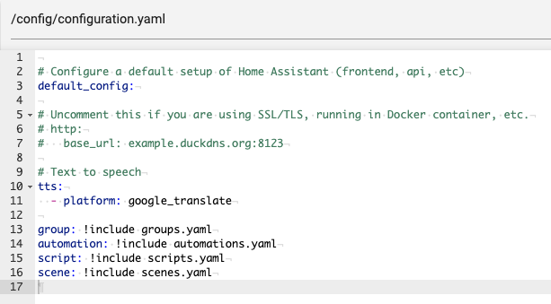

So far no problems. The next step in my learning process is now to have a look at configuration.yaml. I have done a little in this in my first attempt to start using HA over a half year ago when using the micro SD card. As said this info is lost now.
There is no problem in finding this configuration.yaml, but when I have a look at it (in the standard config folder) using the add on ‘File editor’, it looks rather untouched. See below.
This surprises me since I already did some configuration.
My question now: is this normal, can I expect this content of configuration.yaml at this stage, even after I’ve made some configuration? Or is the location of the configuration.yaml that is really used in my situation somewhere else? If so, where can I find it?

What my configuration.yaml file looks like now:
Schermafbeelding 2020-05-09 om 11.22.49
this is the standard configuration.yaml file. When you clnfigure things through the UI it will not change the content of configuration.yaml only when you edit the file manually.

Thnx @Burningstone, that helps. I presume that even though I seem to be using Docker, as you pointed out, that the actual configuration.yaml file in use is in this same file at this same location?

Sorry I don’t get this question. What you mean with “actual configuration.yaml”? There’s only one configuration.yaml file. It’s somewhere on your SSD and it will be automatically mounted to the docker container when you start Home Assistant. Now when you manually edit the configuration.yaml on your SSD,the next time you restart Home Assistant (which will restart the container) the new file will be mounted to the docker container and the changes will be done accordingly.
