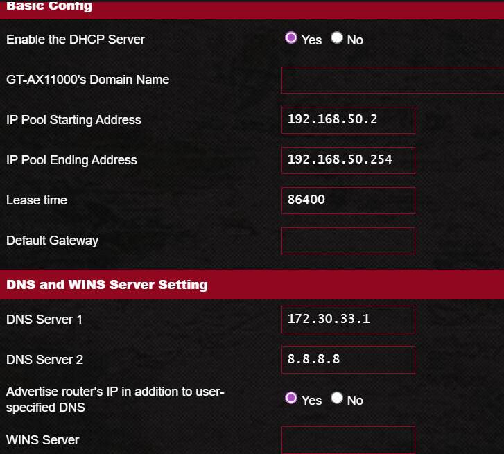

I have attached a picture of my router, and need to know what goes where.

In my router I cannot do a port for the custom DNS. For the DNS I put in 172.30.33.1
Is that the correct IP address? Or should it be something different?
The IP address of the Virtual Box VM is 192.168.50.203
Do I need to open a port on my router?
I checked the adguard dashboard, and there is nothing in there. I do not know what I am missing.
Probably not, this is most likely the network used for containers. If you run AG as an app on your home assistant installation, you should use the home assistant IP.
No, port openings on a home router does not affect internal traffic. It opens up ports from the outside (internet).

When you install adguard home into HA you should be able to access the webgui on http://HA-IP:3000 (http://homeassistant.local:3000) this will just be the UI for adguard home. On you router all you need to add is adguard as the DNS server…so put in the Home Assistant IP address…nothing else…it will automatically send the requests to port 53 which is the default DNS port. so what is happening in the background is that your router will tell everything on your home network to use port 53 on the home assistant IP address…its important that you put in the IP address of home assitant and not the name when you add it to the router DNS setting.
that was odd. If I used the 172.x.x.x IP addresses one of them borked my internet, the other one worked, but I could not get into my router. I had to use the 192.x.x.x IP address.
