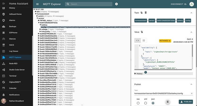

There’s a new add-on that allows you to run MQTT Explorer in Home Assistant and access it in the browser.
- Custom add-on repository: GitHub - adamoutler/mqtt-explorer: A home assistant repository for MQTT Explorer

- Go to Settings => Add-ons
- Click the “Add on store” button in the bottom right
- Click the “…” menu in the top right, and click “Repositories”
- Paste
https://github.com/adamoutler/mqtt-explorerinto the input, then click the “Add” button - Then wait a little while and refresh the page. If you search for MQTT you should now see the add on:
Thanks. I had the wrong repository URL. (GitHub - adamoutler/mqtt-explorer at d313fc55157b63f7dfaba70ba52a67fbce1e0d13).
