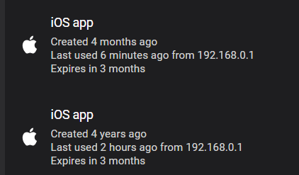

I don’t think you need long lived tokens for the companion app? I’ve never specifically configured a token for my ios apps and I never need to sign in more than once.
