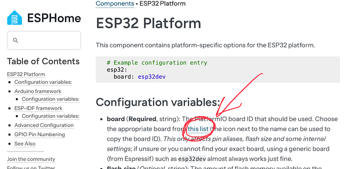

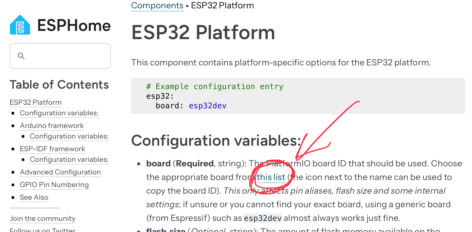

Hi @anon11644107 I’m trying to learn how you figured out the board type. On the ESPhome page I navigate to ESP32 microcontrollers (ESP32 Platform — ESPHome) and from there I can’t seem to figure out where the list of board types is or how you linked the ESP-WROOM-32 to nodemcu-32s as board type?
On the Espressif link you provided it makes it clear that “ESP32-DevKitC contains the entire support circuitry of ESP32-WROOM series, ESP32-WROVER series, and ESP32-SOLO series of modules”, so now I know it’s DevKitC. Next I’m stuck at figuring out the board type for esphome.
Thanks for the quick reply. I should have been clearer that when I visit that link I get stuck at figuring out the correct board type.
I tried searching for “DevKitC”, “Dev Kit C”, "WROOM’ and all the board types that appear aren’t nodemcu-32S
The only way to get that is to search for “nodemcu-32s”. What I’m having a hard time with is how do you go from seeing the physical writing on the esp32 “ESP-WROOM-32” to then figuring out it’s nodemcu-32s?
