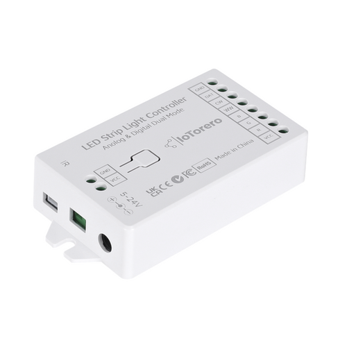

  3. Another route I just came across is Matter over Thread using this LED driver from Gledopto. This will of course drop support through the Hue app, but in some specific cases, that might not be an issue for me if everything works as expected. Any experiences with this driver?
