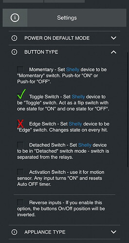

No sure what you mean by this. The Shelly modules can be set up to work with toggle or push button switches. Toggle = on position → light on. Toggle in off position → light off.
ahhhhh i get what it mean … when the physical rocker switch is in the ON position while the light is OFF. I cant see how can you ger around this without replacing all the switch, turn on the light “smartly” and rock the switch to the correct position as well.
The only way that can happen (if set to toggle switch, see below) is if you have two switches in circuit. And that will happen without smart modules installed.

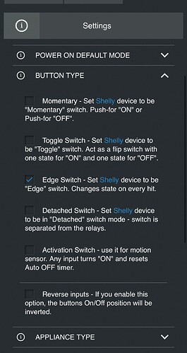

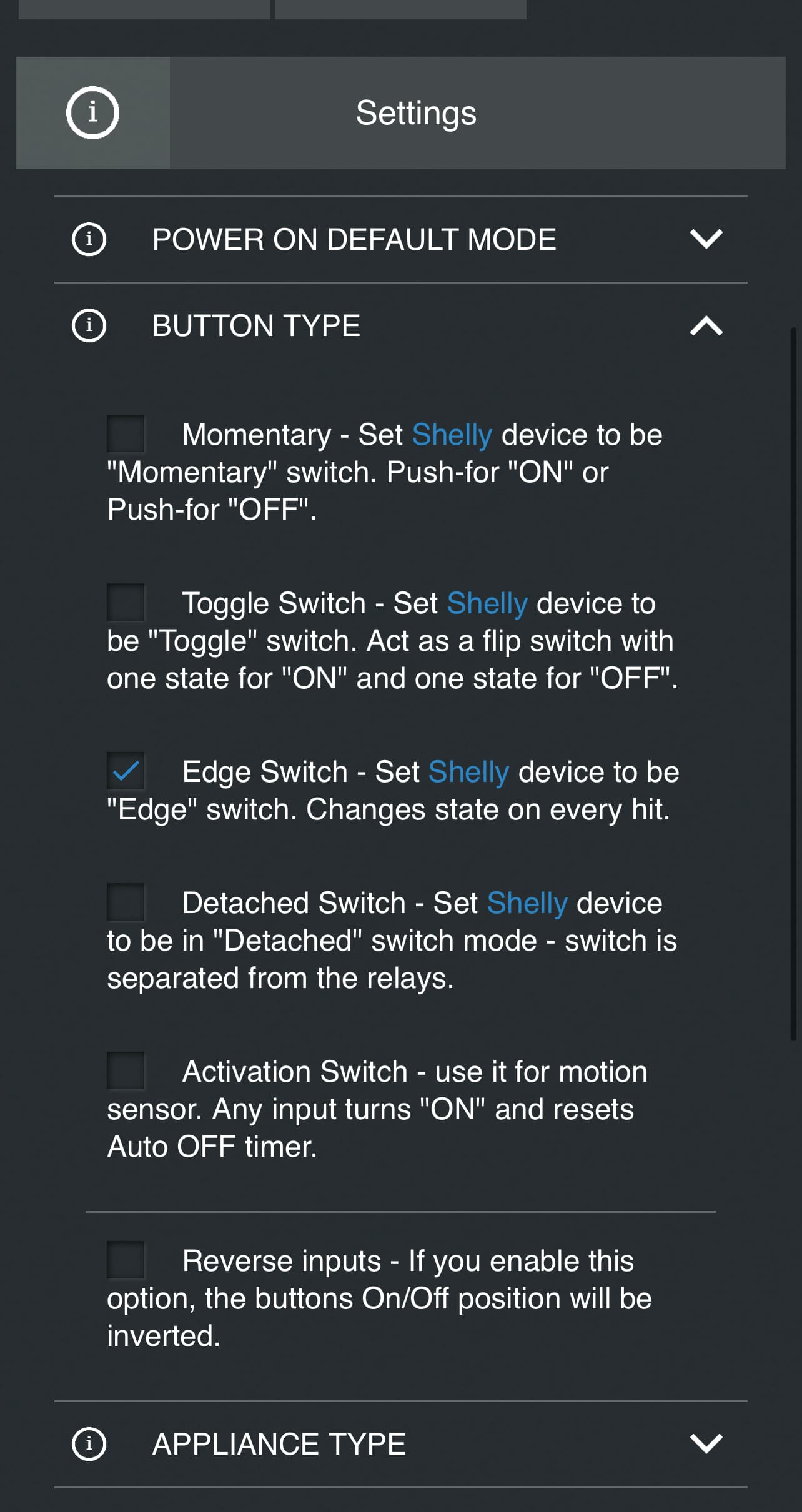

Worth noting the type I have are toggle push button (might be incorrect term), but it means they show as a switch in HA. I have the shelly’s setup in detached mode if connected to smart bulbs or edge switch when connected to dumb bulbs.
I set up that way as well, detached switch on smart light to stop family members from cutting power to it at the wall switch. the only thing i use it as toggle mode is the heated towel rack since there are no visual way to see if it on or off.
