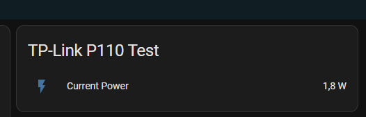

As a counter-evidence I have a WiFi socket (TP-Link Tapo P100) that even gets to read 0.1W, so I remain incredulous that all Zigbee sockets are affected by the same kind of problem. Is it perhaps an inherent limitation of the technology

And finally, a TP-Link Tapo P100, you can see the very low W value
