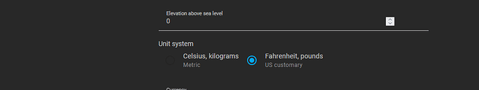

The problem is people put in feet instead of meters. And if you’re in e.g. Colorado and you put in 6800 as the value, your automatons are off by 13 minutes.
The field in the UI is misleading and does not specify units.
But is it stating that it should be elevation above sea level, which is correct for other places, like temperature and weather.
It is just misleading for sun elevation.
HA is wrong here and so are smallfreak.
There is a long thread somewhere on the forum about it and we had to dive into the actual library for the sun calculation and the outcome was that the elevation is the one over the actually ground and not the one over the sea level.
I had the same idea as smallfreak back then, but I was convinced after a rather long decision about it and the diving into the calculations.
The UI is not correct, it should list ā€œobserver elevationā€ instead of ā€œabove sea levelā€. Someone just needs to step up and fix the translation key and phrase in English. All I have been describing in my comments on here and discord, is how the equation in the astral library works. Smallfreak is on some tirade here and github trying to say the calc is wrong and HA is at fault.

This is incorrect. Please see Effect of Elevation from the Astral documentation. Specifically,
If what obscures you at ground level is the horizon and you are at a [sic] elevation above ground level then the times of the sun depends on how far further round the earth you can see due to your elevation (the sun rises earlier and sets later).
As noted, this does not affect calculations for ā€œsolar elevationā€. However, it is used for all methods that calculate when a ā€œsolar eventā€ occurs. Ultimately, sunrise, dawn, etc. call time_of_transit, and shown below is where it uses the ā€œobserver elevationā€, which is either a distance above ground level, or a distance to an obstruction paired with the relative height of the obstruction to the observer.
I’m not an astronomer. I’m just the author of the ā€œSun2ā€ Home Assistant custom integration. My integration, as well as HA’s built-in Sun integration, rely on this astral package. I have no idea how it works, just how to use it.
