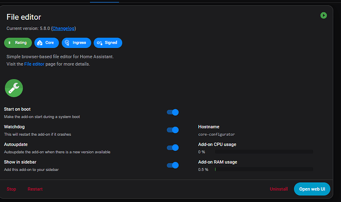

Through the file editor
It’s a hidden folder, you’ll need an addon or separate PC that has the ability to access and view hidden files/folders.

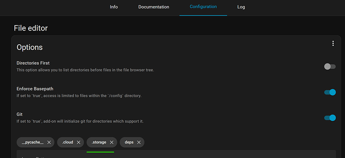

But also … Home Assistant uses Docker (for itself plus addons). The File Editor addon runs in a Docker Container which has a different “view” of the file system. In addons, the “/config” folder is “/homeassistant” (generally). And yeah, it’s pretty unusual to be accessing that folder - it’s hidden for a reason.
