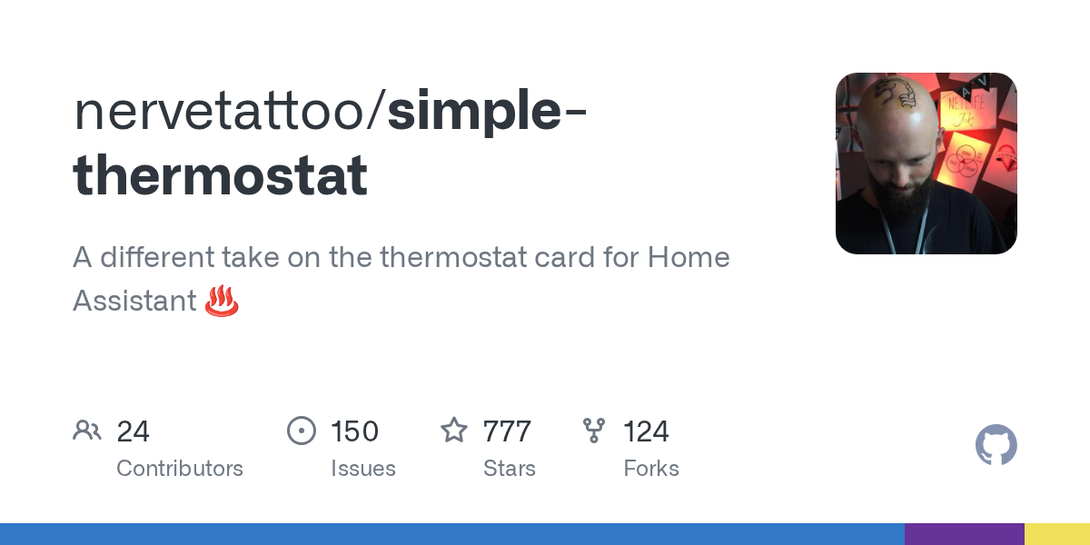

Why did Simple Thermostat get removed from HACS? Is there a replacement?
I’ve been using nervetattoo/simple-thermostat for years to control a number from 0-X with a circular slider. It worked, though with some headaches. Is there some other slider or dumb thermostat that might work?

I heard it was flagged as abandoned and no longer maintained.
Which would not change the github stuff but no longer auto watched by HACS. Should be able to keep it like a custom though.

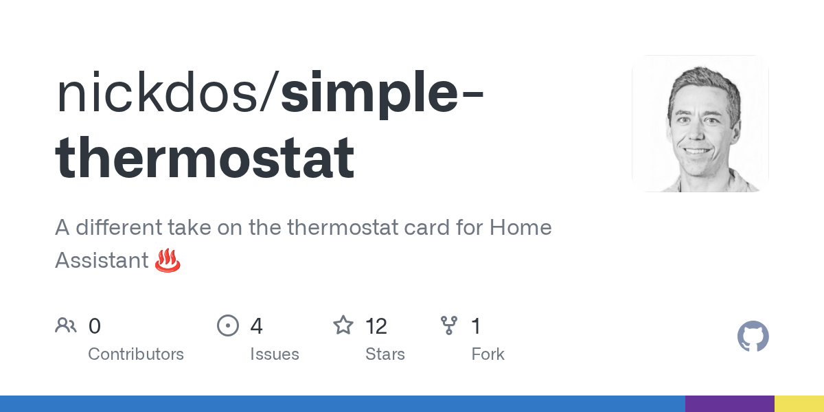

The original repo has not been updated in 3 years. Based on the discussion in the Issues section, some of the critical dependencies are outdated and the owner of the repo is not responding to issue reports or PRs.

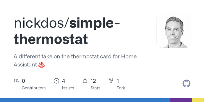

There is an updated fork that you can add using the custom repositories feature in HACS:
I wish people would stop doing this, unless the thing stops actually working.
well, at least I can’t:
<Integration nickdos/simple-thermostat> Repository structure for v2.2.7 is not compliant
When adding the repository, make sure you select Type > Dashboard.
