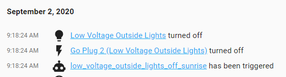

Here is a screenshot of the log where it looks like the automation should have run.
Any thoughts on any other logs to try and confirm what happened?
