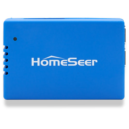

Homeseer released their first Ethernet based Z-wave coordinator in 2015 and have been selling versions of it since then. It isn’t POE but can be easily converted to POE.

HomeSeer has been offering Ethernet-based Z-Wave coordinator interfaces for many years, such as the Z-NET G8 remote Z-Wave controller, which supports both Ethernet and Wi‑Fi network connections. These interfaces can also be integrated with Home Assistant using HomeSeer’s documented Z‑NET integration process
