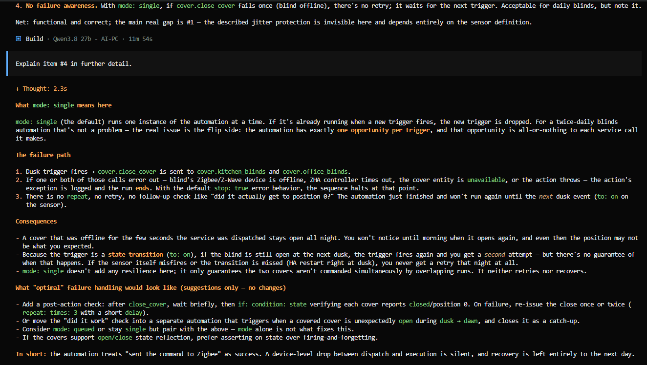

Thanks. I just installed the new qwen3.8.27b which seems a bit faster. It only takes 30 seconds to turn on a light! I also had it analyze one of my automations and it made some intelligent refactoring suggestions. See the screenshot below. Yesterday the qwen3:30b seemed a bit “lost” at times which led me to believe that they need to be trained. However I don’t think that’s the case since OpenCode is the MCP for the AI models, as I understand it.

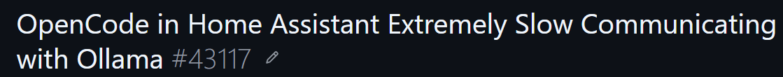

The math problem was just a speed test. Which OpenCode failed miserbly. On my AI PC I can ask what is 2 + 2 and it answers in seconds. In OpenCode it takes many minutes. Forget about math, ANY question I ask on my AI server regardless of model is answered in seconds, not minutes. If there are a “million” reasons why OpenCode could be so slow then it could take forever to figure out. Frankly It seems like a bug to me, there are other tickets open regarding slowness with local AI. Here’s the ticket I opened. We’ll see…
OpenCode in Home Assistant Extremely Slow Communicating with Ollama #43117
