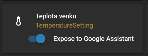

Now I understand - It is not a climate device, it is a standard sensor:
This is how I expose it on Nabu Casa
I’ve not seen that before for sensors, looking at the Google API, there is no such thing as a thermometer or sensor. I wonder if this thinks its an thermostat.
https://developers.google.com/actions/smarthome/guides/
That would explain it. In that case, lucky me :).
It would be nice if I could control the temperature outside from Hassio though :slight_smile:
Are you on the latest version of Home assistant?
Yes. I think @callifo explained that well. Google API does not have a thermometer device, so Nabu Casa smartly linked that to a thermostat device, that also measures temperature but also turns the heating on and off. So it is saying the heating is off. Never mind, better than nothing.
