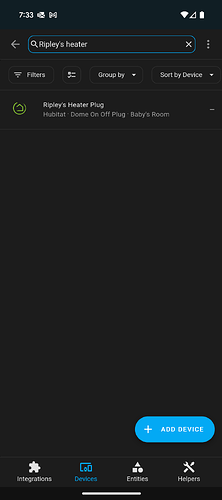

here is photo of one of my plugs

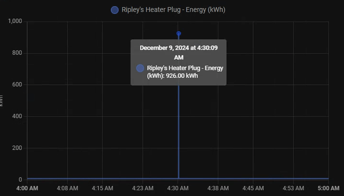

Can you post a picture of the history (the graph) of the entity in HA when it jumps? If you have a power entity, show that history as well for the same timeframe.
Sure, below is the plugs energy entity history and you can see the spike in the reading at 4am yesterday. I apologize I do have the history graph for the utility meter but it is now a corrected history as I was working on a SQL query for others to use to fix this issue if it happens to them so they can clean up their short and long term history. Good thing is, I was successful in correcting the issue in my DB with a SQL query but bad new is it’s gone from my history now on the Utility Meter. I’ll be sure to capture it if it happens again!
So we can see the reading spiked to 926.00kWh at 4:30AM
