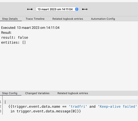

this did work before, so unless system internals have changed, something I can not get my finger behind this.
new post now, because the linked post above is rather old…
I commented the other triggers, because I want to rule out this issue first.
it must be something in the condition, as that wont pass:
