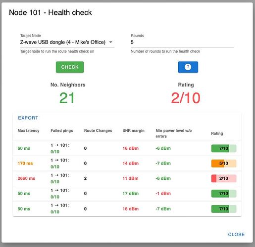

First, @cornellrwilliams I’ve run the “diagnose” command a number of times and have no idea how to interpret what I’m seeing:
Here’s a node 12’ away from my controller (unobstructed line-of-sight):
Here’s one 15’ away through a (wood stud + drywall) wall:
Here are 2 more:
The SNR’s are all positive. Many of these nodes are operational, but the score out of 10 does not inspire confidence… Is this good or bad? What are the takeaways?
More broadly, I’m continuing to see “unable to transmit” messages in my logs. And now it’s taking a long time (several minutes) after opening Z-wave JS UI to see any nodes listed (even my controller)… during which time the icon third-from-right at the top of Z-wave JS UI flashes back and forth between red and green (“disconnected” and “connected”).

- If you click the question mark it explains the scoring system. Also everything is color coded so green is good and red is bad. For example:
If you have 1 failed ping the highest score you will get is a 3.
If you have a latency higher than 1000ms the highest score you can get is a 2.
If you have 2 or less neighbors the highest score you can get is a 6.
If your SNR is great than or equal to 17dbm you will get an 8 or higher. The higher your SNR is the better your score will be.
If your minimum power level w/o errors is -6dbm then you will get an 8 or higher. I believe the power level goes from -10dbm to +20dbm? At least that is what Z-Wave JS UI will allow me to set -10dbm is the lowest and +20dbm is the highest. Pretty much the more power you use the lower your score will be.
according to my report normal power is equal to 0dbm which is the max amount of power you can use in mesh mode.
Pretty much the takeaway is that your device is using more power to transmit and still having trouble.

- A 0-3 is bad, 4-6 is better, and 7-10 is the best.
