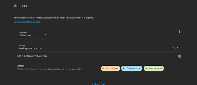

Ah, still complaining about HA and comparing it to OpenHAB I see. And still hung up on devices. I suggest you take time to learn about home assistant services as thatâs how everything turns on and off. The UI does give you this option. Hereâs what it looks like.
Call Service gets the job done in this case. Sill a bit convoluted if you ask me.
I found it as you posted. And yes, Iâm still comparing. The more I learn the better off I can be to help others at some point.
