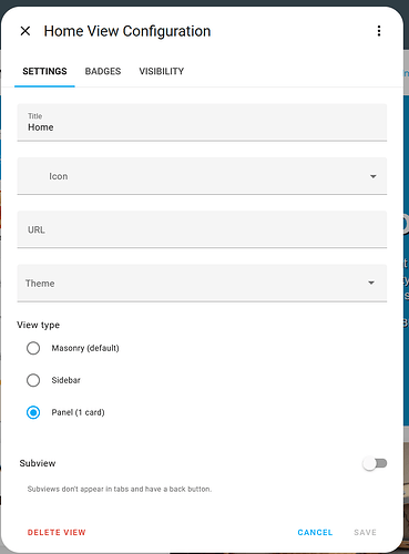

So not even close to full screen. Can somebody please tell me why the same code isn’t doing the same thing with two different pages? Screenshots are taken on my PC, and it’s not because the page won’t go bigger. Here’s the same page in Chrome without Home Assistant:
I had forgotten to go beyond the normal code edit and to the raw edit from the upper left three dots! Working now.
