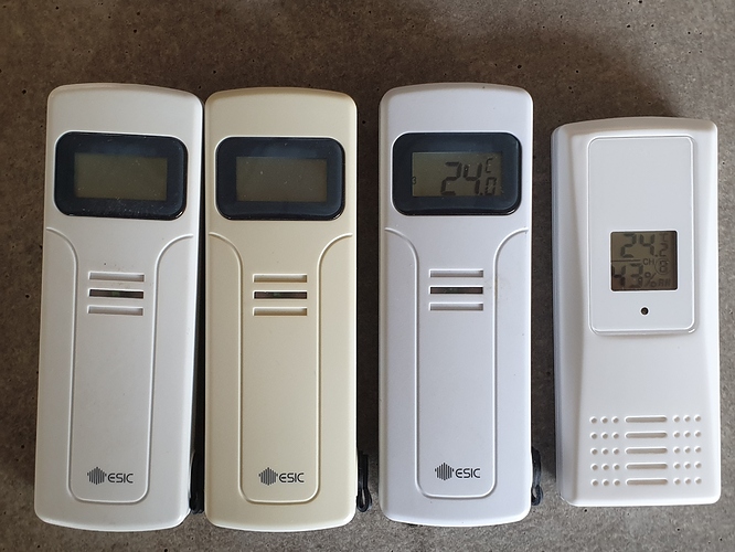

When ever i have the sensors in customize.yaml with a friedly name they randomly appear on reboot or not. None are discovered even if i physically move them. As soon as i take out the customize.yaml from configuration.yaml or just remove the sensors from (with #) customize.yaml they appear 100 % every time, if i restart them or change the channel they appear immediately once they start to transpond.
