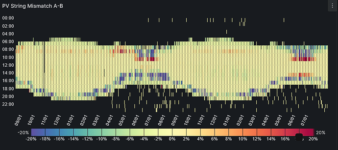

The reason I use InfluxDB is because there are many visualisations I can create with Grafana that are not possible (or a lot more difficult) with the options available in Home Assistant. e.g. Monitoring shading on my solar panels:
Having a separate visualisation suite to Lovelace is not an issue for me.
